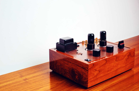

Another completed Moreplay!

Really enjoyed putting together this kit, super detailed instructions and all testing was spot on first go. I’ve had it running for a couple weeks now and it sounds just incredible, props to the design team! Looking forward to those future upgrade(s) too!
I have one question though. Getting a bit of an electronics/warm plastics smell when on, appears a minute or so after startup. Seems to be somewhat lessening now, but still noticeable. I’m assuming a wire might be near a particular hot resistor, any particular one(s) to give extra breathing room maybe? My build looks identical to the final build photo in the manual, wires under and over where they should be and nothing directly touching.

Odd smell aside, that is one fine looking build.

I have to say that you did a very good job of detailing that Moreplay. It looks amazing!
My only thought is perhaps the odor is coming from the finish as it fully cures.
Thanks! It was a tough call whether or not to keep it unpainted. The new finish on the top plates straight from the box looks really good!
