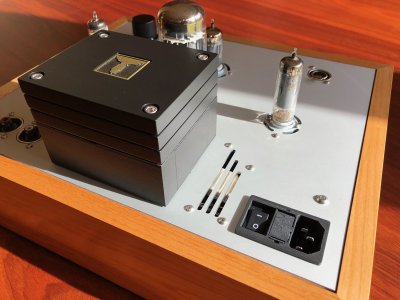

- custom chassis plate with single undermount inputs, undermount 4 PIN XLR (wired as TRS), all-in-one IEC/fuse/switch
- custom end bell machined from 10mm aluminium plate in 3 pieces with nylon spacers for ventilation and a recess for the Bottlehead badge. Requires a 3 inch 8-32 unc bolt. I chose a stainless socket cap. I had considered using one of those full enclosures but was unsure about heat. I can say that this version barely gets warm even after extended listening, despite being close to the 6AS7GA which puts out some heat.
- Goldpoint V47 with Spinal Tap "goes up to 11" volume index
I'm happy with how it turned out and how it sounds though I've only tried it with HD650 so far. Time to invest is something like HD800s or some ZMF.
I'm keen to build another Mainline with similar treatment but go a bit further by undermounting the tubes and eliminating the visible screws. If anyone has done something like that please share.

Wow, this is a nice looking one! Very unique and coherent design. What is the finish on the top plate please, it looks great.

Thanks sl-15. It's an anodised finish, called 'Natural', its a matte silver.

Very nice indeed. The transformer looks even better than the can covered ones, IMO.
I have had a couple of custom top plates made with studs attached to the bottom to eliminate many of the screws - happy with the cleaner look. I've never tried under mounting tubes, but it looks like you have a handle on the software, I'm sure you'll work it out. Looking forward to pics of a maxed out Mainline incorporating the above. What about adding custom graphics? (I never mind spending someone else's money)

The socket housings are from Neutrik model NF2D. I swapped out the actual RCA sockets for some WBT items I had from another project. (WBT-0210 Cu RCA). Too pricey and I doubt I can hear any difference, but nice to solder and use. Had to drill out the Neutrik housings very slightly using a step drill bit, but the material is fairly soft and it is easy to achieve a neat job.

Thanks Karl. I was thinking to use the studs, glad to hear you've been there and are happy with the result, I'll give it a go. Yes, I'm keen on adding some graphics/script to the next project, let's see how I go.
