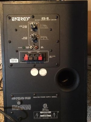

I have an Energy ES-8 powered sub and thought about hooking that up to provide better bass.
But, when I went to hook it up, I realized the sub has high level speaker inputs but no high-level speaker outputs.

Yes, you just have to run two pieces of cable.  The load on the speaker jacks of the subwoofer plate amp is probably something around 10,000 ohms, and that in parallel with a speaker will still look like an 8 ohm load to the SEX amp.
Putting bare wire into the binding posts is the way to go to get this done.

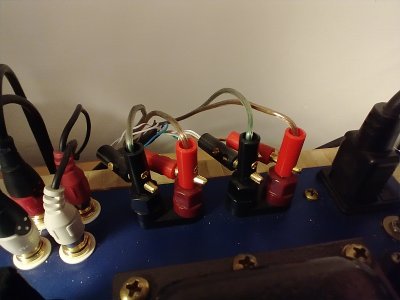

I also connect bare wire and a banana plug to the same binding post in several places in my speaker chain. Just tighten the nut down on the bare wire like usual then push the banana plug into the center of the nut. Works like a charm. Let me know if you want a picture.

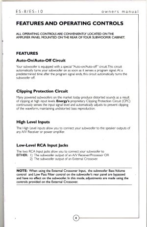

The manual does state that if one uses the low-level RCA inputs (which I'm not), bass volume control and crossover network are bypassed. It says no such thing regarding the high level speaker inputs which I'm using. When using the high level inputs, the volume control definitely works and it seems adjusting the frequency filter makes a difference as well.
 I have attached the page from the manual which is sparse on details.

" ... which is sparse on details"
Indeed it is!
No distinction is made in the manual between the low-pass and high-pass outputs of a crossover, which leads to confusion.
If I read it right, the RCA inputs have no low-pass filter, presumably on the assumption that you are using an external crossover such as a home theater preamp might have.
The speaker level inputs do have a low-pass filter, of course. Many subs also have a simple high pass filter (often I believe just a capacitor) with speaker-level outputs separate from the (full-range) inputs. The ES-8 does not have separate speaker-level outputs, so it cannot have an internal speaker-level high-pass filter.
I believe Pete is correct - using the ES-8 does not relieve the satellites from handling the deep bass signals. To do so, you'd need a passive, speaker-level high-pass filter, the design of which would be specific to the speaker being used. A simple capacitor would not IMHO be satisfactory, because of the substantial impedance fluctuations of most speakers.

The Home Despot's had/have some banana plugs with a hole that a second plug fits into - see photo.
