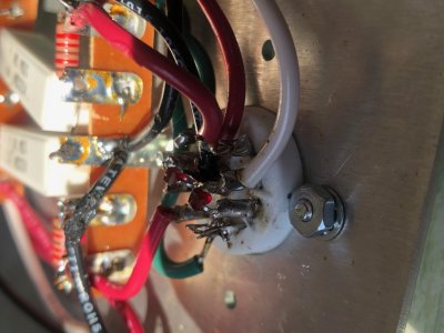

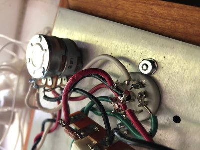

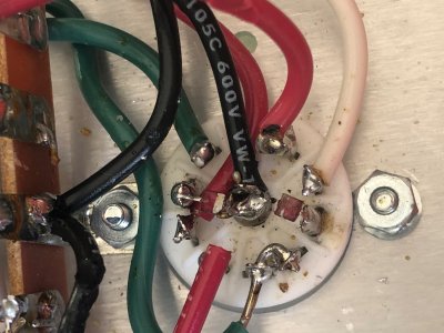

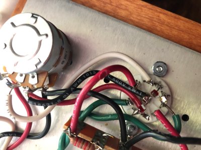

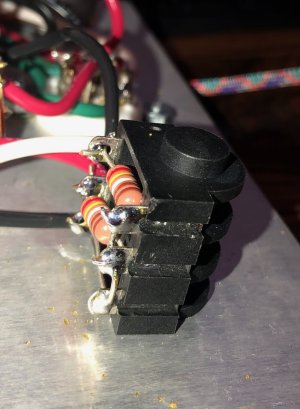

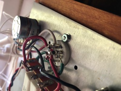

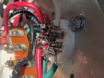

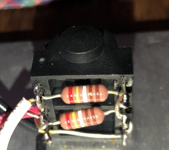

I’ve been loving my Crack ever since I completed the build a few months ago. I had some more consistent crackling/popping a little while back but have since addressed that through some additional soldering work. However, lately I have also noticed some very occasional popping noises in just the left earphone. Generally it’s so slight that I don’t notice it when listening to music anyway. The only time the issue presents itself to me is when I’m listening to a podcast, am between songs, etc. I have noticed that when I jiggle the small 12AU7 bulb around, the popping occurs, so I think I’ve largely been able to narrow down the issue to some soldering around that connector. I have tried taking some photos of the existing solder work around there, as well as around the headphone jack. Since the problem seems to be exclusive to the left earphone, I wasn’t 100% sure my issue didn’t lie with my soldering around that component instead. However, as stated before, the crackling sound becomes routine when the small bulb is messed with during playback.
Any help would be greatly appreciated! I’d be happy to try to take more pictures of specific soldering joints, as needed.

The junction of the 2.49K resistor and white wire on the headphone jack is suspect, as is the solder joint at A6.
Be sure to use leaded rosin core solder with your iron turned all the way up if it's adjustable.
    • Posts: 9793
Reply #2 on: October 13, 2022, 11:30:21 AM
I'd suggest touching up A1 as well.

And while you're at it, give the tube pins a good cleaning...John

After a bit of soldering work, I think I inadvertently made my problem a bit worse. Now there is a constant very low buzz sound. I suspect the problem is with my LEDs... I think both are too tight, first of all, as it requires some elbow grease to insert the 12AU7 bulb - I'm not sure if this is normal. There doesn't seem to be a lot of extra slack or bend in the leads to allow for flexing. Additionally, and more importantly, one of the leads was not soldered well. Due to the clutter of other wires, I had an extremely difficult time trying to get one of the leads through the hole in the pin. I am not confident in either LED connection, to be honest, and may need to try getting replacement LEDs and trying to start over. Would any of my issues possibly be indicative of bad solders with the LEDs?

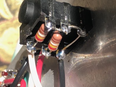

    • Posts: 9793
Reply #10 on: October 14, 2022, 06:09:40 AM
Black wire at the headphone jack.
    • Posts: 20300
Reply #11 on: October 14, 2022, 06:09:51 AM

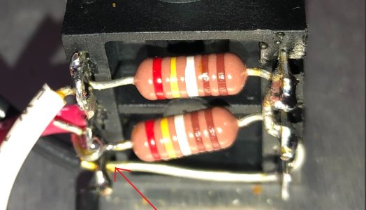

Now that you mention it, where the black wires meet on the headphone jack you have a black wire that's not captured by solder.  This is a pretty common issue that I see on at least half of the Cracks that I receive for repair.

Reply #13 on: October 14, 2022, 11:46:37 AM
This is the wire that's not soldered.

    • Posts: 42
Reply #14 on: October 14, 2022, 11:49:52 AM
Yeah, that’s the one I thought I touched up - I’ll double check. I just prodded the smaller tube while watching the LEDs/with headphones on. I heard a popping sound, almost like a relief sound and I noticed one of my LEDs go dark. The humming/popping sound also seemed to cease at this time. After maybe 5-10 seconds, that LED lit back up.
