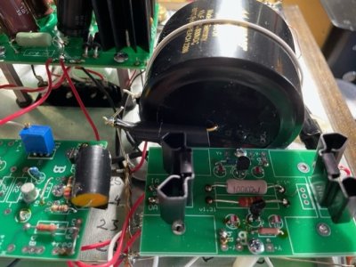

I swapped out my Jantzen Audio Z-Cap (800vdc, 15uf) with Mundorf MCap Supreme Evo Silver Gold Oil (800vdc, 10uf).
As the wire does not align correctly, i had to bridge the connection with a Separate Wire.
After power on, all 3 Tube lights up but no sound from the headphone. I think i waited around 30 seconds and turn off.
I attached a picture of my bridge connection - which i think is likely the issue.

One more data point - i used an ohm meter to check the connections; and all 2 sides of both capacitors seems to be well connected. Measures a fluctuating 2 ohms with other wire that is supposed to be connected to it.
Do i need to adjust anything with the capacitor change (e.g. 15uf to 10uf)?

Can you put the old caps back and recheck?

Resolved. Turn out to be much simpler problem. Need to plug in the correct source cable.
