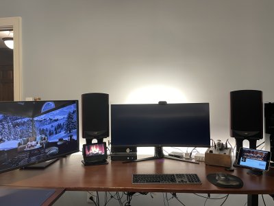

For even more confirmation of SeX working with low sensitivity speakers in a small room (with subs though), take a look at my embarrassingly glowing review here:
https://forum.bottlehead.com/index.php?topic=13966.0
Colin. Insta @act4audio

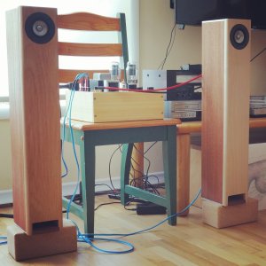

Offline jufelling
    • Posts: 22
Reply #8 on: February 08, 2023, 09:30:40 PM
