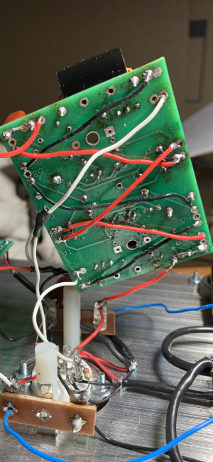

Reply #13 on: January 24, 2023, 12:47:47 PM
Here’s are the photos
    • Posts: 20249
Reply #14 on: January 24, 2023, 02:42:21 PM
I would watch this video:
I see some joints that aren't really soldered, many cold joints, and some that really could use a little more heat.  Also be sure you are using 60/40 leaded rosin core solder.
