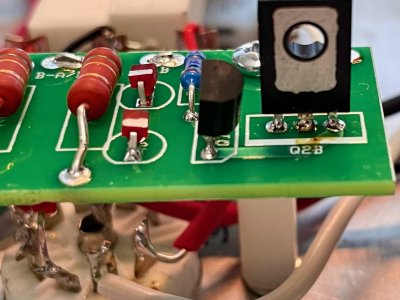

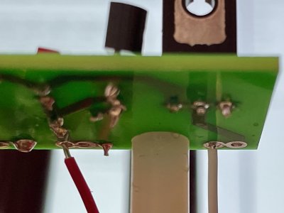

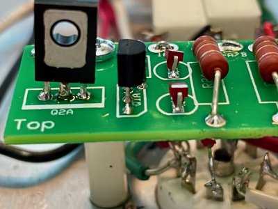

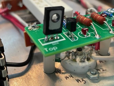

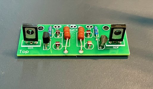

Can you post photos of the top and bottom of the small PC board?
I would expect that you don't have the center legs of the MJE350s well soldered. If your 12AU7 glows, it would be very important to leave the LEDs on the 9 pin socket alone.

Reply #2 on: March 10, 2023, 05:46:22 AM

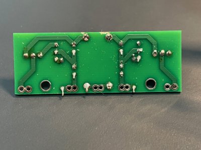

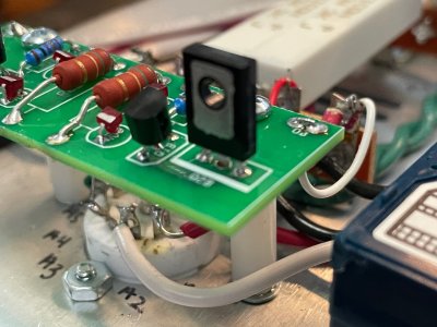

Here you go.
Cheers,
Pedro
    • Posts: 9780
Reply #3 on: March 10, 2023, 06:01:28 AM
Look at the center leg of each MJE350 on the top side of the
PC board photo. There needs to be solder between the leg and the solder pad. Watch this starting at about 36:05  -

Can you carefully measure the voltages at A3 and A8?  Can you repost the photos of that board?
Also keep in mind that if you try to just add solder from the other side of the board rather than reheating the joints from the bottom, you are unlikely to resolve the issue (I just mention this because we have seen it happen a bunch).

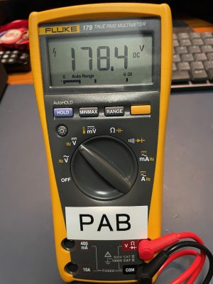

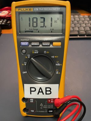

A3 = 180.6 V
A8 = 182.2 V

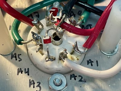

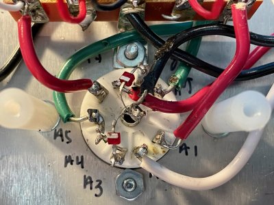

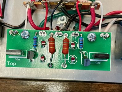

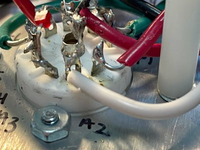

Reply #12 on: March 10, 2023, 07:02:12 AM

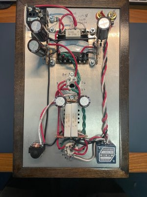

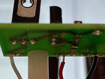

ok, here are photos of the 9 pin socket and the stock build
Cheers,
Pedro
    • Posts: 20282

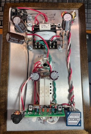

Reply #13 on: March 10, 2023, 07:03:44 AM
Could I see an overhead of the whole build?
A4 and A5 don't look well soldered.
If you have 180V at A3 and A8, then I would be very, very surprised if your stock build functioned properly and passed its original voltage checks.

Reply #14 on: March 10, 2023, 07:06:21 AM
When you say you want to see overhead, you mean right side up?  It worked fine for the last year plus that I have had it.  I will resolder all the pins on the 9 pin socket.
