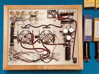

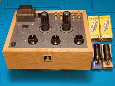

My current system is similar to yours in a couple of respects, and maybe my experience will be of some value. My digital steamer is feeding a DAC and my turntable feeds a phono-pre. The DAC and phono-pre both feed my Moreplay. The Moreplay outs feeds a 6-channel EQ. Everything up to this point is single-ended. The EQ's balanced outs feed a Hypex Nilai 500 Stereo Amp, which only has balanced input. The Nilai speaker outs feed my subwoofers speaker level inputs, and its speaker outs feed my speakers.
Regarding the pairing of the Moreplay with Class D, well it's superb. I also have a pair of ACA Class A monoblocks, 15W/channel. I prefer the Nilia to the ACA's.

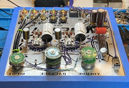

Well, the Nilia is the latest addition so it's only seen duty with the Moreplay Preamp. While the Nilia has yet to be widely reviewed, it's gaining a reputation for being relatively laid back and smooth, for a Class D. I was interested in trying Class D with my Moreplay based on this thread, which might be of interest to you: https://forum.bottlehead.com/index.php?topic=15040.msg136232#msg136232 . I started looking for a good but not crazy expensive (<$1500) class D amp and ran across Alpha Audio's shoot out video that included the Nilia: https://www.youtube.com/live/NdZFAWe1Nxo?si=M8GmQq_vLfJuMTLX . Based on that video, listening to it using headphones, I felt the Nilia had the better sound, fairly close to Alpha Audio's reference amp, the Pass Labs X150.8. Listening to it might give you a sense of the Nilia's character compared to the much more expensive Pass Labs class A/B, and to class D Purifi and ICEpower.
I do have a solid state Schiit Saga preamp that was replaced by the Moreplay. I have been meaning to put it back in for comparison with my Moreplay. I will set that up in the next day or two and report back.
As a side note, I happen to have two Moreplays that I built at the same time, as an experiment to try to determine whether or not the upgrades are audible. One is stock and the other is heavily upgraded (pics attached). I have compared them and I have to admit that the stock unit is difficult to distinguish from the upgrade.

Offline joralieu
    • Posts: 104
Reply #10 on: February 08, 2024, 06:07:17 AM
Hmbscot, what are the knobs on your modded moreplay?

hmbscott .... you need to enter those modded kits into some type of contest .... all are just awesome!

Paul, I have been admiring your build portfolio. I've reviewed it several times after I discovered it. You sir are an artist! I may take you up on that someday. (edit: I'm a little red faced Paul, I just realized your comment probably wasn't aimed at me, nevertheless I may hit you up for advice some day).
joralieu, I bought four different types and decided I liked these the best: https://www.amazon.com/gp/product/B08L4XYYFV/ref=ppx_yo_dt_b_asin_title_o05_s00?ie=UTF8&psc=1
