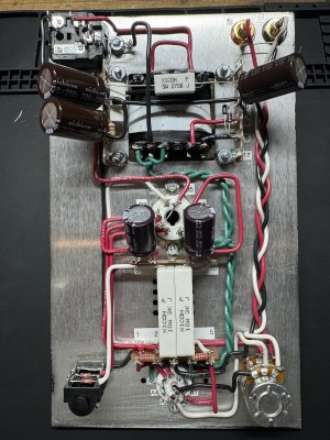

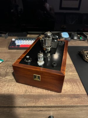

here are pics of my build:

    • Posts: 20294
Reply #6 on: July 07, 2024, 05:39:37 AM
I'm asking what the voltage is that you measured during the test on page 22 of the manual.
