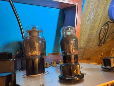

Reply #13 on: December 17, 2024, 07:21:20 AM
Here are the Morconi Tubes I've been using.
