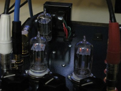

My foreplay ll has been working fine for the past 3-4 months after sleeping for about 21 years.
In the past couple of weeks it has developed a hum on both channels.
Tonight I totally rearranged my stereo system rerouting cables thinking interference from the cables, separated signal cables from ac cables, hooked it back up and hum still there.
But this time when I turned it on still humming I noticed for the first time that my right channel tube is glowing red-hot on top, the left channel seems normal. SEE PICTURE.
I never noticed it before tonight.
Another thing I noticed is if I wave my fingers or hand over the top of the right channel tube without touching it the hum will get louder and when I move my hand away from it the hum goes lower again, weird.
Im not experienced with electronics even though I built it and a seduction and a pair of 300b mono blocks back in 2002-2003, and was a member here back then (same name) but I'm just now getting back into my tube gear.
I used my system for about 1.5 years before they got packed away and the system sounded amazing.
Im hoping it's a minor issue and would appreciate help with figuring out the issue. Thanks.

It's not unusual to have different brightness of one or even both section's cathodes like that. You can exchange the two tubes to see if the brightness follows the tube, which is likely. If the hum remains - I expect it will - then it's probably not a bad tube.

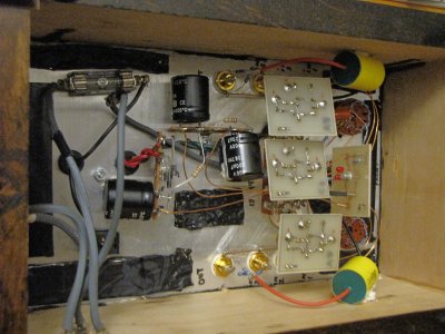

While you are in there, inspect each capacitor for swelling. And take some pictures of the build and post them. Then do the voltage checks near the end of the manual, and post them as well. That will give us much more information for diagnosis.

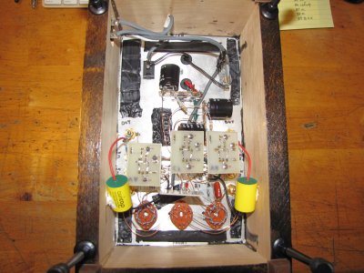

I do have some more pictures and voltages to share. The black strips are pieces of sound dampening.

I can see your 0.1uF cap in your build.

The 0.1uF capacitor is located between the right-hand volume control and the adjacent B tube socket - I apologize, I was working from the circuit diagram instead of the physical layout (too lazy to go downstairs and pull out the manual ...).
