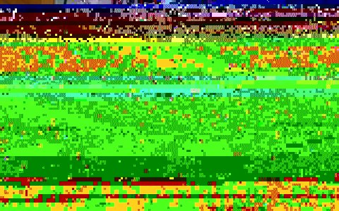

Reply #3 on: May 30, 2011, 01:09:10 PM
Hi Granger,
Thank you for the post. I think that I follow what you are saying but will post a photo for you to look at and confirm. Attached is a photo of how I plan to install them/. Can you please take a look at it and tell me if I am correct?

Reply #5 on: May 30, 2011, 01:59:22 PM
Brian,
It looks to me that the larger Auricaps are right.  What I can't see is where the wires on the terminal strips go for the smaller Auricaps.  Like I said, with the smaller cap one lead, black, goes to the driver the red lead to the 2A3.
My amps are Paramours, an earlier mono-block version of the Stereomour.

Reply #7 on: May 31, 2011, 01:48:58 AM
That is how I have my Auricaps aligned (but it is great to have the theory and confirmation from folks who know best).  http://www.bottlehead.com/smf/index.php/topic,849.30.html

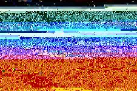

Reply #13 on: June 16, 2011, 06:41:58 PM
I went "up" which becomes "down" rather than out....
(https://forum.bottlehead.com/proxy.php?request=http%3A%2F%2Fwww.hawthorneaudio.com%2Fphotos%2Falbums%2Fuserpics%2F11473%2Fnormal_photo-222.JPG&hash=2f6379488e70ee7be9e2c07cd5b9eec16a9fccbd)

Reply #14 on: June 16, 2011, 11:33:46 PM
John,
I have a number of "dangling" capacitors.  It harms nothing.  Next you should try breaking in a Kommie Kap Teflon and bypassing your existing with it.  They are cheap, excellent sounding and add sparkle to most systems.
You can break them in then test with alligator clip jumpers.  I did the first time.  It allowed me to put them in and out several times to verify what I heard.  Since I just solder them in because they always make a positive difference in my system.
