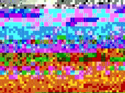

Offline machinehead
    • Posts: 57
Reply #11 on: March 14, 2010, 06:52:55 AM
here is my quickie with REL caps AudioCap Theta series, yes I need to re-route the ground wire, right now it is sitting under the cap.
Can't wait for them to break in, the at first listen not much difference to the broken in stock film caps.
So I am hoping once these break in it will be a noticeable improvement.  I do here more upper octave details and better spread of sound stage,
not quite so centered in the middle of the sound stage.
