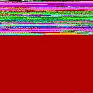

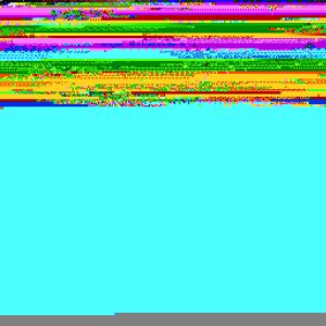

I'm working on a modified PS in PSUD for a build.  I'm barely a novice but can punch in the numbers and thought others might like to see this so far.
It will be a voltage doubler CLCLC design but I'm unsure if my results are good.  Any input would be greatly appreciated.
There are two photos, one with an electrolytic second stage and a second with a film cap second stage of a lower value.

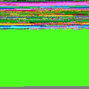

Reply #2 on: September 29, 2013, 06:53:23 AM
Something like this?  Where the voltage stabilizes?  If not, where should I be zooming in on?
    • Posts: 20348
Reply #3 on: September 29, 2013, 06:55:43 AM
Yeah, now you can zoom in on the line on the right end where it flattens out.

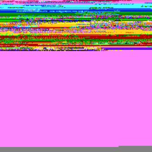

Reply #4 on: September 29, 2013, 07:05:11 AM
Got it!  Here is the design with electrolytics in the second stage and 100uF final at 3,000ms.  I can't see any ripple.  Is this zoomed in enough?
    • Posts: 20348
Reply #5 on: September 29, 2013, 07:08:31 AM
Keep zooming in until you see the ripple.  (Remember, 3mV of ripple is 0.003V, so you may have to zoom way in)
Offline johnsonad
    • Posts: 1670
Reply #6 on: September 29, 2013, 07:25:42 AM
Got it though I'm not sure how to measure how much ripple that is.....
    • Posts: 20348
Reply #7 on: September 29, 2013, 07:28:04 AM
Less than 1mV.

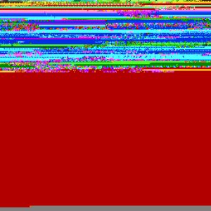

I just ran the sim and wow, that is a difference.....  Thank you for recommending the design.
Rise response, I must be speaking out of terms.  I understand it as the time it take to achieve output voltage.  The shape and speed of the voltage rise. Does this have an real bearing on the design or should I focus strictly on the ripple?
    • Posts: 20348
Reply #11 on: September 29, 2013, 08:03:28 AM
The simulation is pretty limited, it assumes that you have a load on the power supply the instant you flick the switch, which you do not.  You can try a stepped load simulation, try 5mA of current for 5 seconds, then full current.  You may see a decent spike in the DC voltage during startup, though this is not anything to be particularly worried about.

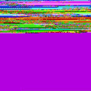

Reply #14 on: September 29, 2013, 08:53:00 AM
I'm going to try the 350v, 50mA, 5k OP to start.  Here is the ripple with the last LC stage removed. The voltage is up 17v or so.
