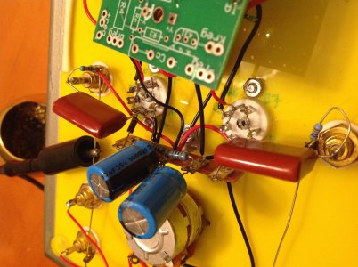

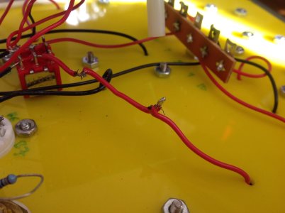

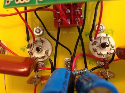

One problem may be that I accidentally severed the red wire from the left D cell and had to doctor a connection. See pic. This might be the source of the problem? Though I'm getting 1.64 volts at the end of that wire...
Do you still want me to replace batteries and recheck voltages?

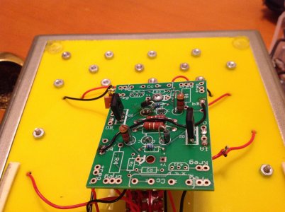

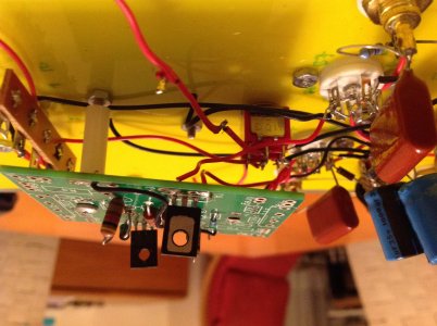

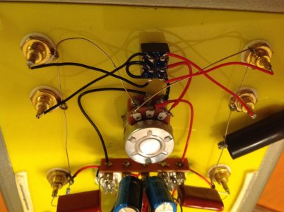

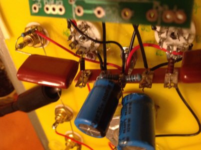

No, that can't be right. I'm at a loss. I'll study the pictures and think for a while - maybe PB will join if he sees anything. Whatever it is, it's the same both sides.
Meanwhile, could you post a picture of the PC board, and another picture of the tube sockets showing what's under the electrolytic caps?
I think it might help to see the voltage at each tube pin. Get the voltages on the PC board wires as well - bA, IA, IB, OA, OB. This is mostly to make it easier to go forward, without re-reading the thread, and to be sure nothing has changed so far. I know this is repetitive, but since it does not make sense there must be some assumption I'm making that is not true - re-checking all the available data is a starting point for that.

Reply #12 on: February 01, 2015, 02:25:15 PM
Pics

    • Posts: 5908
Reply #13 on: February 01, 2015, 05:16:01 PM
Bingo! I think I've got it.
B5 should go to the 1000 ohm bias resistor; you have the resistor going to B1/B7.
This may be my fault - I will review the notes in the sticky about the D-cell fix.
When that is fixed, you should see the pin 5 voltages make sense, and the plate voltage will increase ~10 volts, giving you more headroom in the output.
I still puzzle over the 6mA current reading, but the voltages now make sense so I speculate that was a fluke (sorry!).
