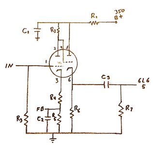

Here is the input schematic through the 6SL7.  When I purchased the amp, I was told that a 6SL7 or 6SN7 would work without modification.  I've only used 6SL7.
R1:  I understand this to be a voltage dropping resistor used to set the proper voltage on the anodes.  It is 22K in the schematic but no indication of what the proper wattage should be.
R2:  I understand this to further drop the voltage to the anode in the first stage.  It also appears to be doing double-duty in setting the grid voltage for the second stage.  It is 100K in the schematic.
C1:  This cap is 47uF in the schematic and I assume it provides further filtration of the B+ on this side of R1.
R3:  470K, I'm guessing here, but I would say it sets the input impedance and provides voltage differential for the input.
C2, R4, R5:  This part of the schematic differs from others I've seen online.  Many schematics I see simply use R4, a 1K to ground and have the feedback come in on the other side directly to pin 3.  C2 is 47uF and R5 is 300 ohms.  Is this some kind of filter?  This combination would roll off around 11 hz.
R6:  Assuming same job as R4 in setting the voltage on the cathode.  Just for the second stage instead of the first.  47K here.
C3, R7:  Coupling capacitor to next stage.  I've seen this vary from schematic to schematic.  Mine shows 022uF, another shows 1.0uF.  I have a nice Mundorf that is .33uF that I was considering.  R7 seems to be ding what R3 did in the previous stage.
OK, that's my knowledge of tube amps so far, at least until I do some more reading.  I'm curious to hear any comments and/or suggestions.  I'm in no big hurry to finish the build.  Rather do things right and want to know why I'm doing it.

Reply #1 on: February 19, 2015, 07:25:02 AM
That would depend massively on whether you wanted to use a 6SN7 or 6SL7 (sorry, I couldn't resist)
R2 is the plate load.  On the curves for the tube that you're using, put a dot on the voltage axis for the voltage at the junction of R2 and R1, then divide that voltage by the value of R2 to get maximum current that can be drawn through that resistor, then put a dot on the current axis.  Connect those two dots and you have a load line.  R2 should be very different for a 6SL7 vs. 6SN7.
Yes.
R3 does set the input impedance.  It also serves to let some stray electrons from the grid go to ground.  If you set it too high, those electrons will create some voltage across that resistor.  If you set it to low, your preamp will hate you.
This is a problem with this schematic.  Feedback is generally a signal voltage sourced from the output transformer.  With C2 in its current place, you'll short that feedback voltage to ground (so it won't do anything).  Oops...
R6 has the same job as R2.
Yeah, pretty much.  Just remember that F=1/(2*Pi*R*C), and shoot for F=5Hz.
I'd be curious to see the rest of the build.  The cathode follower driving the 6L6 is a little bit curious, as is the statement that a 6SN7 and 6SL7 will work with the same component values, as well as the feedback connection.
I'm happy to work through this with you, but I'll post outside of office hours to keep the boss happy  ;)

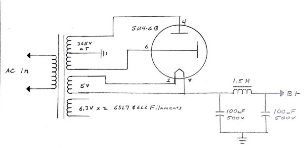

Right now, I have the chassis with octal sockets put together and have the power supply (5U4GB from center-tapped transformer) with CLC network.
I'm guessing that I will need to build the circuit (both preamp and power stage) before being able to take an accurate voltage measurement between R1 and R2.  Then I can make adjustments according to the load line and curves?

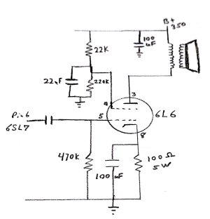

OK, here is a drawing of the output schematic.  The amp had 6L6 tubes installed when I got it and I never replaced them with anything else.  The original builder claimed the following tubes would also work:  EL34/KT77/6V6/6F6/6K6/KT88.
I would prefer to stick with the 6L6 and optimize that option.

Reply #7 on: February 20, 2015, 01:10:06 PM
I would suggest giving this design a try:
http://www.tubeaudio.8m.com/807/807.html
You'll end up needing one 9 pin socket and two octal sockets instead of the four octal sockets you have now, but it's workable.
If that design doesn't interest you, then the thing to do would be to list the power transformer and output transformer you have, then we may be able to make good suggestions.

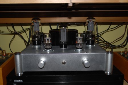

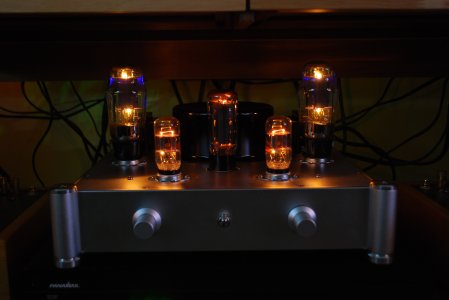

A couple of recent snow days from school has given me the opportunity to get this project together.  I can't tell you how many times I wished I had the bottlehead manual to tell me exactly how to cut the wire and where to attach it.  Laying out the parts can be a real challenge and made me appreciate what Doc and the team to for us.
So, here's the short:  It works, and actually sounds pretty good.  Oscilloscope says that it has pretty linear response and isn't clipping unless I severely over-drive the input.  I've put in about 12 hours of listening so far and it is very pleasing.  It won't replace any of my BH amps but this was a learning exercise.
Anyway, here are some pics.  I will post later with my measurements and a ton of questions.  Not the least of which is why PB is chuckling over the cathode follower design.

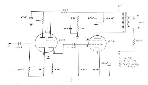

First picture is the schematic for the input and power tubes, Second and third are day and night pictures of the amp.

Reply #13 on: March 08, 2015, 04:23:33 PM
Good job wrapping it up!
Have a listen to the amp with the junction of the 22uf/220K resistor connected to the cathode instead of ground (probably w/o the 220K resistor).  That is technically a requirement for pentode operation, and certainly an experiment that's basically free.
You should be able to dump the 1.5uF cap at the input too, though it doesn't hurt anything to leave it there.

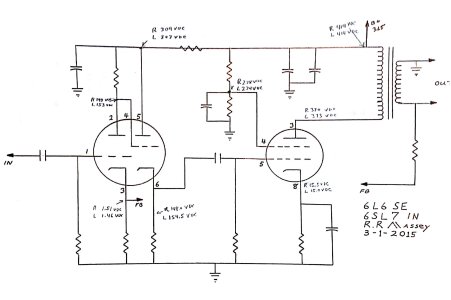

Offline porcupunctis
    • Posts: 386
  • 0D3
Reply #14 on: March 09, 2015, 01:58:55 PM
OK, my first real concern (before I do some modding) is that when I checked my voltages, it seems to be running a bit high.  For instance, Pin 5 of the 6SL7 is running just under 310 volts and the data sheet recommends a 300 volt max.  My overall B+ is 414 volts which is 50 volts over what was listed on the schematic.
Here is the schematic with voltage measurements at  points of interest:
