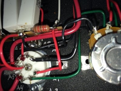

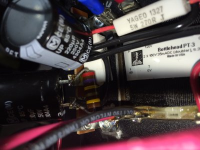

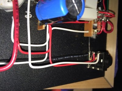

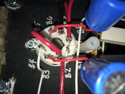

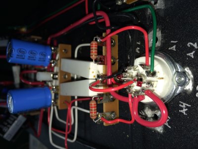

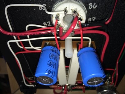

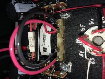

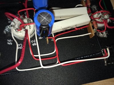

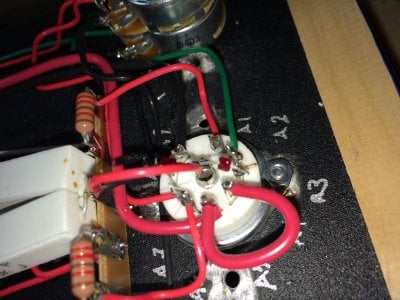

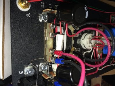

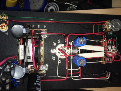

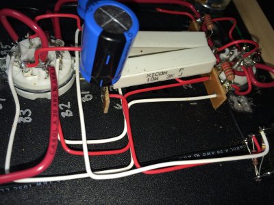

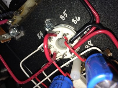

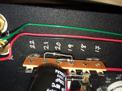

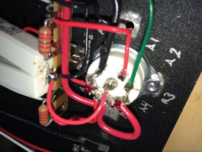

Here are some photos. If there is something else that I may have missed, please let me know.
I have 0 volts at A7
Reply #11 on: April 01, 2015, 01:35:15 PM
1.   When you get this running, it's going to be noisy.  The combination of untwisted heater wires and the straight input wiring is going to cause other problems for you.  (Only solved by pulling out what's there)
2.  The carbon composition resistor at the last cap is not a good idea.  It will be noisier than the resistor we provide.
3.  The power transformer jumpers, why are they that long? Why aren't they twisted?  (Same with the A4/5 jumper)
4.  Try wiring a jumper from A3 to A8 to see if that corrects the voltage at terminal 1. (A short jumper)

Reply #12 on: April 01, 2015, 02:47:28 PM
Hey PB,
I used the carbon resistor because I was short a resistor in one of my BH kits, so I took it from the crack. I wasn't going to receive my new package of resistors for a few weeks until the smash upgrade was shipped. So I made a quick purchase off of eBay and they were the top search within spec. I can change it out.
I'll do the wire twist when I install the SB. I didn't think it would make a big difference but I'll do it.
I installed the jumper, both voltages are now within range, both channels work. The only thing that is still not working is the A8 LED. Any ideas?
Thanks for all of the help PB, Grainger, and SFP

Reply #13 on: April 01, 2015, 05:02:14 PM
You can leave the amp as-is.  Either the LED on A8 is not well connected, or it got damaged in the installation.
