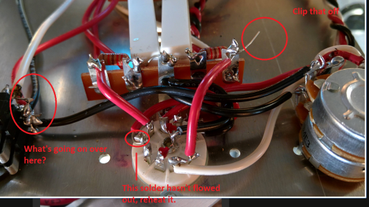

Here are some pictures:
http://imgur.com/a/293t7
(I created an online album since it crashed twice when I was trying to upload it here)

Reply #8 on: July 29, 2015, 03:09:01 AM
Black and red shorting on transformer to the left of the 5W resistor on picture #1?

Reply #10 on: July 29, 2015, 03:34:09 AM
Any solder on 12L?
I have noticed on a number of terminals the solder is used like chewing gum to stick the leads or wires in place.  It is a good practice to wet the terminal till it flows through the hole.
I suspect you have a number of "cold solder joints" in your build.
But those would not cause smoke.  They would cause no voltage in a number of places.  We haven't found the answer.  Although the transformer wires in the first picture, as Deluk points out, makes it look like those terminals are shorted.  Try measuring resistance from one lug to the other.  It should be low but not under an Ohm.

Reply #13 on: July 31, 2015, 06:02:16 AM
Thank you very much for the response.
I actually didn't understand what you meant by "red black wire shorting" in the first picture. What's exactly is wrong again?
And do you think the soldering isn't good enough? I really tried to bend the wire into the hole so it would stick there, and only after that I soldered it.
And here's another album of the other terminals (plus some headphone jack pictures):
http://imgur.com/a/sBzBA
Thank you again! I'd be glad to get additional help to solve my issue.

Reply #14 on: July 31, 2015, 06:58:12 AM
Hi!
You have very much solder on several joints, especially obvious on the jack connector.
Some kinds of solder are hard to work with. Do You know what kind You have?
I have learned a great deal from these professional but easy to grasp videos: https://www.youtube.com/playlist?list=PL926EC0F1F93C1837
Also some of Your leads are dangerously long, and should be stripped.
Anyway, I know it is hard to slow down the build, but I am sure You will get the hang of it. It all comes down to practice and quite a bit of patience.
