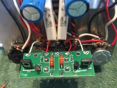

Yes, I do believe that I have the resistors in the correct position. Here is a picture.

Looks OK on the top. Do you have both tubes installed when you are doing the voltage check? Heaters glowing? Do the LEDS on the nine pin socket light? Sure you are grounding your black test lead at T12?

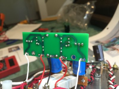

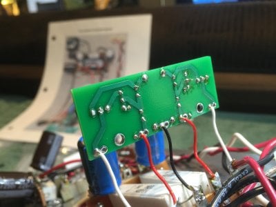

Few pix of the back....

This may be clutching at straws, but it also looks from the underside shots like possibly one leg of the removed and reversed pn2907 might not be going all the way thru the hole. You might just reflow those 2907 connections one more time, paying attention to how the solder pulls in around the pads.
