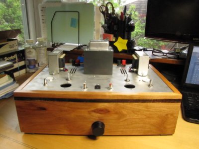

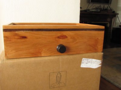

Just arrived, big heavy box. Can't wait to start. I already made a cherry base for it, hope the plate fits
Still need to order the EML Tubes and V-Cap caps. I am doing a couple of mods right from the start, having built three kits already and modified them, I feel pretty comfortable with the design mods I'll be making.

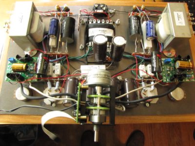

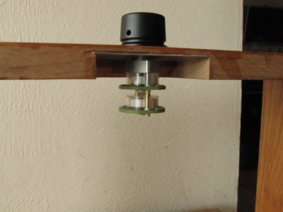

I have attached some photos of my input wiring with Goldpoint and servo motor volume control.

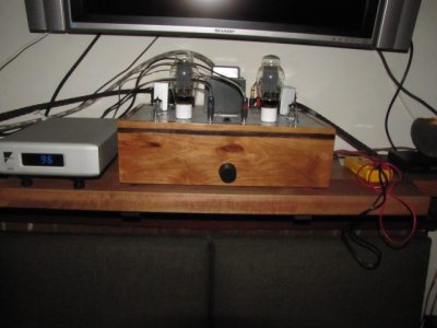

So after about 10 hours I thought I would post a quick review. All this is in comparison to a modded stereomour FYI.
So, wow. I am impressed. Bass is deep and well defined. Instrument separation and clarity are excellent. Has just the extra punch and volume I need with my 92 dB speakers. Vocals are amazing, right where they should be and slighly forward. Most 3d presentation of any amp i have owned. It improved on pretty much everything. And I really enjoyed the stereomour. The only thing I am missing a bit are the super crisp cymbals but things are not even settled in yet. Can't wait to hear it with the Eml's. Should have them later this week. I am glad I waited for this amp. Just what I wanted. Gonna set the stereomour up in the bedroom with a small pair of hemp speakers.
