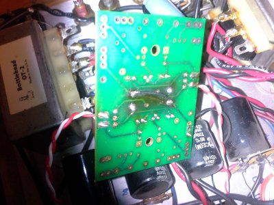

I was going to post my c4s problem amd saw this thread.
Well, my c4s is eating led's. Every six months or so one channel led will go bust and that channel will stop working. I ordered a set from BH and got 4 of them. Now I am down to one. I have changed tubes.
On  the rear of the board,  where a " jumper" Wire is, there is a discolouration.
Any suggestions. If it matters, I am on 240v.

Reply #1 on: March 20, 2017, 07:38:08 AM
Can you post a photo of your SEX PCB?

Offline proud indian
    • Posts: 159
Reply #3 on: March 20, 2017, 06:00:49 PM
Hopt I got it right.

Reply #4 on: March 21, 2017, 06:38:14 AM
What's your line voltage? What voltage is your power transformer rated for?  Are the 8.2K resistors in place?
Those resistors are charred because there's too much B+ across them.  Having used many of that exact resistor across the exact voltage that's supposed to be present in the kit, that amount of discoloration is almost certainly an indicator of too much available voltage.

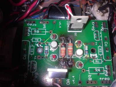

Offline Mordicai
    • Posts: 174
Reply #7 on: March 27, 2017, 11:20:21 AM
I have the same problem. Running 125 v. The left channel went out about three weeks ago and I have been unable to find the cause. Only my resistors on the B side are blackened.
Offline Mordicai
    • Posts: 174
Reply #8 on: March 27, 2017, 12:10:19 PM
As you can see both 150 resistors are fried. Only the 499 on the b side is blackened(https://forum.bottlehead.com/proxy.php?request=http%3A%2F%2Fwww.pbase.com%2Fmordicai%2Fimage%2F165195657&hash=e75d51b5ec31df2a2343632b9cb5bb82565caa57)
Offline Mordicai
    • Posts: 174
Reply #9 on: March 27, 2017, 12:16:28 PM

Offline Mordicai
    • Posts: 174
Reply #11 on: March 30, 2017, 12:46:36 PM
My sex has been down for three weeks. So far unable to find the problem, and seem to be losing the incentive to try. My voltage at OA is 66; OB 56. Don't know if thats excessive or not. Of course thats with 125 line voltage. When yu loose a channel does it first click on and off for a while, or just quit allot once?

Offline Mordicai
    • Posts: 174
Reply #14 on: April 01, 2017, 06:05:44 AM
That is exactly how my Sex acts!!!  On, then pop off, then on, then pop off and no more on. The difference is that all my LED's are lit up and when I take to the work bench, flip it over, hook up power, a source and some phones it plays just great except to a brief pop now and then.  I'm wearing out a chopstick looking for the offending gremlin.
