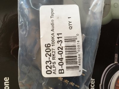

Hi, new crack owner here. I've researched extensively and can't quite find a straightforward answer. Is this the correct Alps pot to use for the Crack? https://w ww.parts-express.com/alps-100kax2-100k-ohm-audio-taper-stereo-potentiometer-6mm-shaft--023-206
Just wanted to make sure it's the best fitting/most compatible and easiest to install Alps blue velvet pot for the crack. Also, does anyone have experience ordering one of these through parts express? Wanted to make sure it is not a knock off. Sorry about the URL, can't post links yet. Thanks!

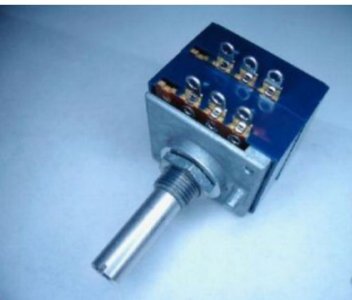

I've been trying to find a reliable source for the lugged version, like this which would be really nice for soldering:
https://www.ebay.com/itm/Japan-Alps-Blue-Velvet-100K-Volume-Control-Potentiometer-Tube-Amplifier/361490171877?epid=1081861570&hash=item542a7e47e5:g:NggAAOxyn~pR0kbS
Not sure I trust this ^^ source however!

Reply #6 on: June 13, 2018, 03:46:53 AM
Here's the factory website with the different RK27 pots:
https://www.alps.com/prod/info/E/HTML/Potentiometer/RotaryPotentiometers/RK271/RK271_list.html
They all have pins.
If you buy an Alps RK27 with solder lugs, I have some pink $100 bills to sell you!  (Note that we have had at least one fake over the years that sounded pretty good)

The parts express 100K ohm Alps is not labeled as an RK27.  I wonder if it's the same as an RK27 Alps.  Looks like it . . . but it is strange that "RK27" isn't referenced.
Yeah I had thought the same thing. Nowhere on the PE site is the manf part # from Alps mentioned. Tried to ask their online chat about it today...didn't know jack of course. I went ahead and ordered anyway. It's faster and cheaper than mouser and looks pretty identical.
