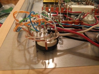

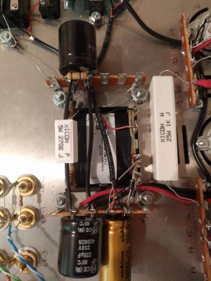

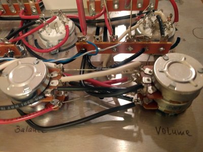

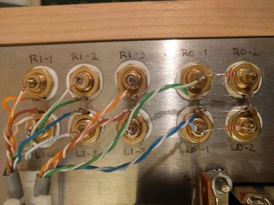

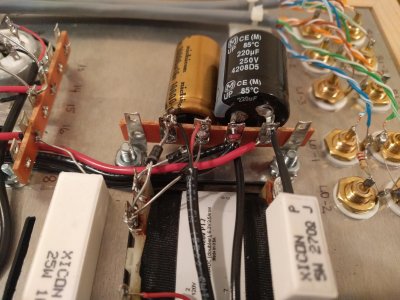

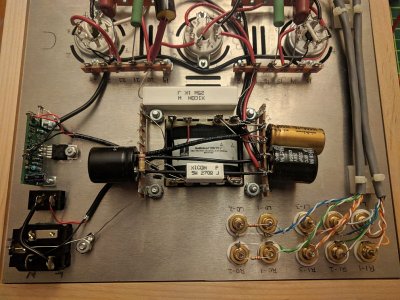

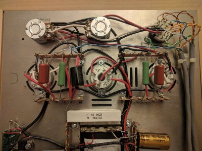

Reply #7 on: February 17, 2019, 07:19:23 AM
Here are a few pics of the Smash build...
    • Posts: 20282
Reply #8 on: February 17, 2019, 08:46:46 AM
Can I see the other side of the filament regulator PCB?  How about the rest of the build?

    • Posts: 84
Reply #9 on: February 17, 2019, 09:07:16 AM

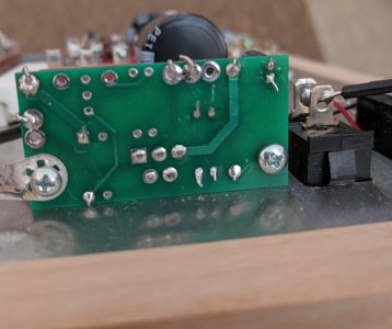

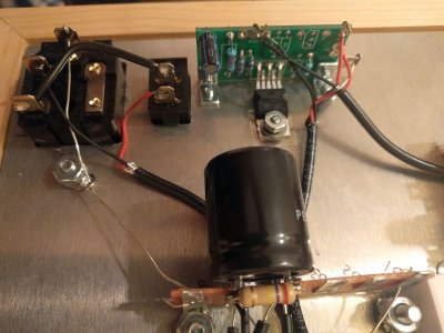

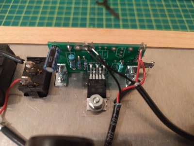

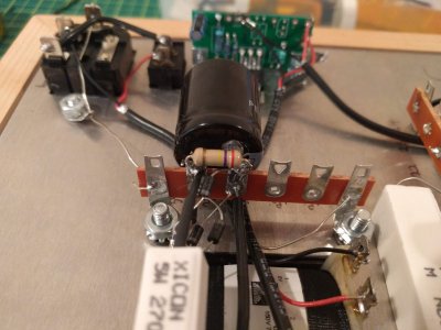

Hi Paul,
I have attached a few more pics, including a close-up of the back of the PC board.
    • Posts: 20282
Reply #10 on: February 17, 2019, 09:22:40 AM
Resistance reading at the "GND" pad show 360 Ohms on the black wire end, OL on the tab.
OL at the ground tab on the PC board?  The ground tab is grounded to the chassis.  If you see "OL" there, then your chassis isn't grounded. This is a contradiction since 6U touches the chassis and the grounding lug touches the chassis.  You are using 6U as your ground reference correct?
There is 360 ohms (approximately) of resistance between "OUT" and "GND" on the PC board, can you verify this measurement?

    • Posts: 20282
Reply #14 on: February 17, 2019, 11:09:56 AM
Yeah, so I'd review the mounting instructions for the heatsink mounting kit.  The metal tab of the L-200 was touching the chassis and causing these issues.  This can happen if the shoulder washer isn't properly installed onto the metal tab of the L200, or if the mica insulator is well out of position.
