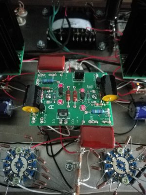

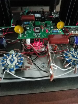

Should I check all Solder joints in the Amp or only these near the Input and Power Tube?
During the Build I've checked almost all Solder Joint with my eyes and my multimeter(checked the connections from one solder joint to another with the Impedance check that its always shows 0.00 Ohms).

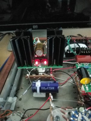

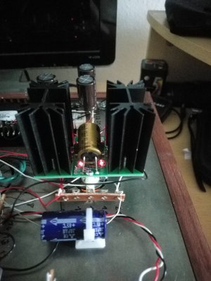

In the Input socket both leds are lit bright if the amp is On, only on the Larger PC Board I've noticed that the Leds on it doesn't lit so brightly like the Others Leds did.
