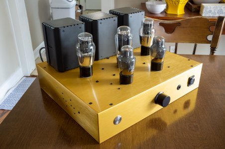

The 5K:8/16 transformer recommendation is a good one.   I just finished a similar project and found that the high step-down ratio was a good idea.  It wasn't heater hum or power supply buzz that was audible, but rather tube rush.  Since you're on our forum, I'll plug our SEX Iron ugprade package for this, with is a 40H plate choke and 4K OPT that would be perfect for this project.
Yes, CCS dissipation is pretty brutal at 6W.  You'd want a big heatsink, maybe 7C/W or lower to whisk that heat away.  You could also load the 45 with a pentode to move that heat above the chassis plate, which would help with the lifetime of all the components inside the amp.

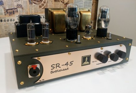

That is a beautiful amplifier, really like the color scheme and accents, has a sort of "steam punk" vibe.  Is it getting a production run :) how fortunate you had the same experience with the transformers - duly noted, I suppose it is all but certain then I will us a high-turns-ratio OPT then.  Maybe a ~17:1, the high turns will help my output impedance too for lower impedance headphones.

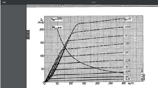

Here's a set of pentode curves for the E55L with the screen grid 125V above the cathode.  For what you're proposing to do, you could use a pair of 60V diodes in series connected to the cathode, then a dropping resistor from B+ to the zeners to get yourself a screen supply that's reasonably well regulated with respect to the cathode.  Screen current is about 4mA, and you could look at the zener datasheets to see what kind of current they would like to maintain decent regulation in order to calculate the value for your dropping resistor.
40mA of current corresponds to 3.25V of bias on the E55L.  Screen current plus plate current is 44mA, so that's a 73 ohm resistor that you would place between the #45 plate and the E55L cathode.  Then you would connect the #45 plate to E55L G1.  The 73 ohm resistor could be a 100 ohm pot that you could adjust to get your desired plate current with some precision.
If you wanted to be a little lazier, if you have 400V of B+ and 180V on the plate, then you'd want the E55L screen at about 300V.  400V-300V=100V, and we have about 4mA of screen current, so that's a 25K resistor between B+ and the screen (throw in a 1uF cap from screen to cathode as a bypass).  This gives you your pentode CCS with two resistors and one capacitor, and you'll have an impedance of about 30K, so not too shabby.  I picked the E55L because the cathode can be 200V above the heater according to the datasheet, so you can heat it from the 6J5 winding.
The E55L would require a minimum of 25V of compliance, so there is an advantage there with the solid state CCS.

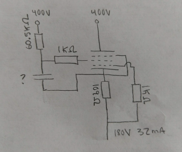

Reply #8 on: March 11, 2020, 09:04:22 AM
Hey PB,
Been doing some reading on pentode CCS.  My big take away is the major advantage of using a pentode lies in the effect of greatly increased internal resistance due to leaving Rk unbypassed.  It should be equal to:
r(ccs) = ra + Rk*(mu+1)
So if I am understanding correctly, I would expect the resistance of the E55L CCS to be higher?  Maybe I am overlooking something, let me know if this makes sense:
mu = gm * ra = 0.045A/V*20,000ohm = 900
r(ccs) = 20,000ohm + 73ohm*(900+1) = 85,773ohm

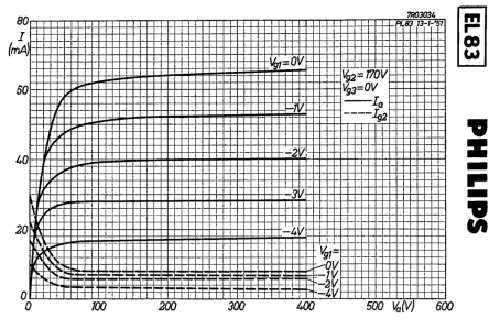

I've been looking over datasheets for some other potential pentodes for this circuit targeting ~31mA g2+cathode current, came up with what I think might be the best option (with some drawbacks, of course), courtesy of Morgan Jones, the EL83.  Attached are the pentode curves at 170V on g2, would target -3V on g1 for a 28mA bias, with Ig2 at ~4ma, would give me close to 31ma out.  Check out these flat curves!
If my understanding/math above is accurate, here is what I would expect for a EL83 r(ccs):
mu = 130,000ohm * 0.010A/V = 1,300
Rk = 3V / 0.028A = 107ohm cathode resistor
r(ccs) = 130,000ohm + 107*(1300+1) = 269K
Obviously a lot less than what is achievable with a MOSFET device.  With a 5K:16 wiring and a 300ohm secondary, would give a reflected primary of 93,750ohm.  A 16ohm resistor in parallel with the 300ohm headphone on the output would drop that back down to 5K, which is an option.  Still, the EL83 has a Pa of 9W, so should be able to handle the voltage drop and get that heat above the chassis.
Two drawbacks with the EL83 are the requirement for elevated heaters (Vkf max is 100V), and the drop out voltage of around 70V.  If my load lines are accurate, I think the 70V dropout will work with my 400V B+.  As an example, I've attached a load line for a 5K primary 8ohm secondary.  The max voltage on the negative grid swing is limited by the symmetrical 0V grid point on the positive swing.  With a 400V B+ and 31V on the 45 grid, overhead is:
400-266-31 = 103V

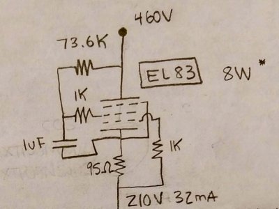

Also attached a schematic of what the CCS might look like, need to figure out the value of the g2 to cathode bypass cap.  I included grid stoppers, and the heaters would need to be elevated at least 100V.
Gotta do my due diligence and see if this would work, but if my numbers are accurate, the performance hit is pretty massive vs. the cascode MOSFET solution.  Have to weigh it against figuring out effective cooling.  More tubes is always fun
though :)
Edit: fixed the orientation of the schematic below.

In the model I worked through, the impedance was pretty dominated by that screen dropping resistor and bypass cap.  These components would still be in parallel with your CCS, but of course the screen bypass cap is reactive so the CCS impedance becomes reactive as well.

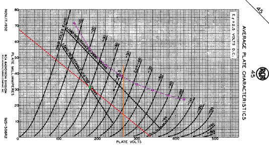

IMO there is definitely a point of diminshing returns when you have something like a #45 with an RP of 1.6K, which is relatively low.  I wouldn't get too excited about going much beyond 16K at 20Hz, which would have performance like a 125H plate choke.  I've also attached some measurements of a random output transformer showing what impedance is actually reflected when unloaded vs. loaded vs. shorted.  This is the end of the world as we know it when a pentode is driving the output transformer, but not so much for a triode that has an amplification factor that's rather stable with changing loading impedance.  It also illustrates that your 5K:16 transformer won't reflect a 100K load in the real world.

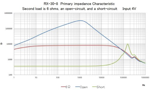

When you move away from the ideal transformer model, you have to deal with all the abnormalities and limits in the transformer design itself that determine the shape of that unloaded curve and the shorted curve, as those are operational boundaries.
« Last Edit: March 11, 2020, 10:22:03 AM by Paul Birkeland »

Very interesting...thanks for the measurements, that does put the transformer limitations in context.  And of course the bypass cap and dropping resistor are in parallel, I overlooked it.  I suppose they limit the achievable performance of a pentode CCS in this configuration.  Well good performance is still very achievable with the EL83, especially if aiming for 16K at 20Hz.
