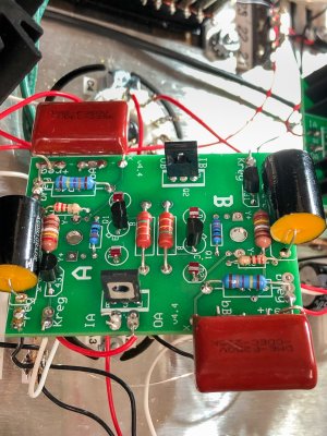

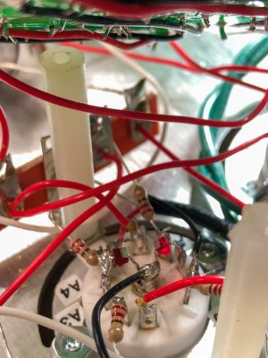

The LED on the left is the problem. I also uploaded a photo of the board above the socket.

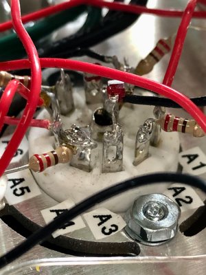

Will do, but here's another view of the pins.
    • Posts: 20295
Reply #9 on: April 20, 2022, 02:55:28 PM
That LED looks to have a crack in it.  Generally a blown LED would produce a voltage of around 12-13V with the amp on, so if you see that you will need to replace that LED.  It's also important to reiterate that if an LED doesn't glow, there are loads of external causes that can produce that symptom, and the fragile LEDs don't handle a lot of extra heat from a soldering iron.
