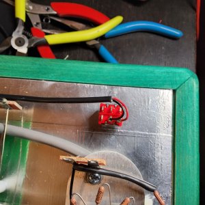

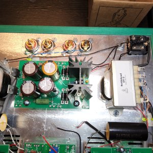

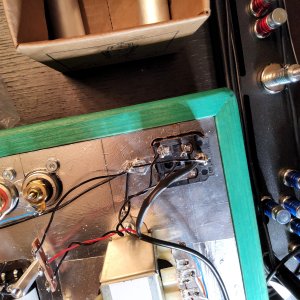

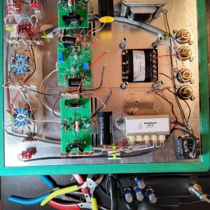

just found out only if te switch is flipped to power side the wall socket fuse won't jump. I have changed cable and rebuild the switch cable and what can be wrong ? can u check the photos? thanks very much.

You have a dead short to ground at the 3 position terminal strip at the power transformer. re read those steps and correct that.

Tks so much good catch. I will redo it today. I have used the wrong 3 terminal plate instead of the 5 cut to 3.

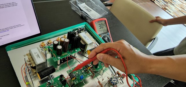

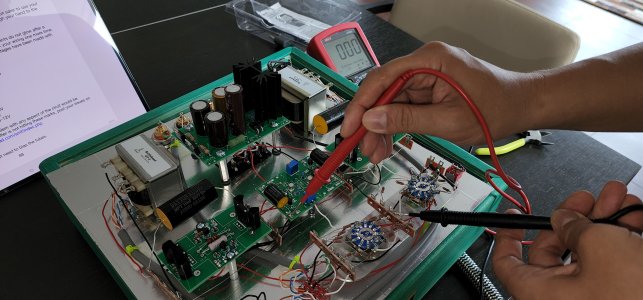

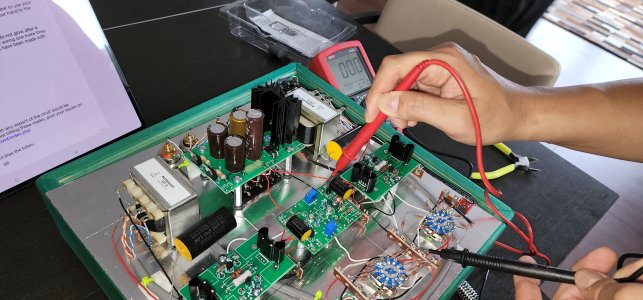

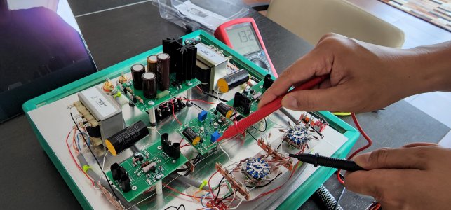

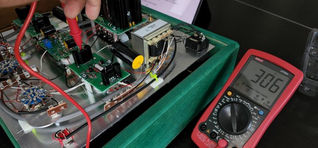

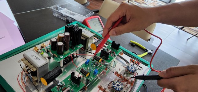

tks for the time and input to answer. all good now except the kreg A side reading is 1v instead of 10-12v. b side is fine at 10v. any though?

IA, Breg, and OB are all OK on both sides but you have 1V at KregB? Those results are not probable.

Yes I have check twice. But I shall do it again tmr and post photo of each reading.

It's incredibly unlikely to have 1V at a Kreg terminal and both Breg terminals reading correctly.
